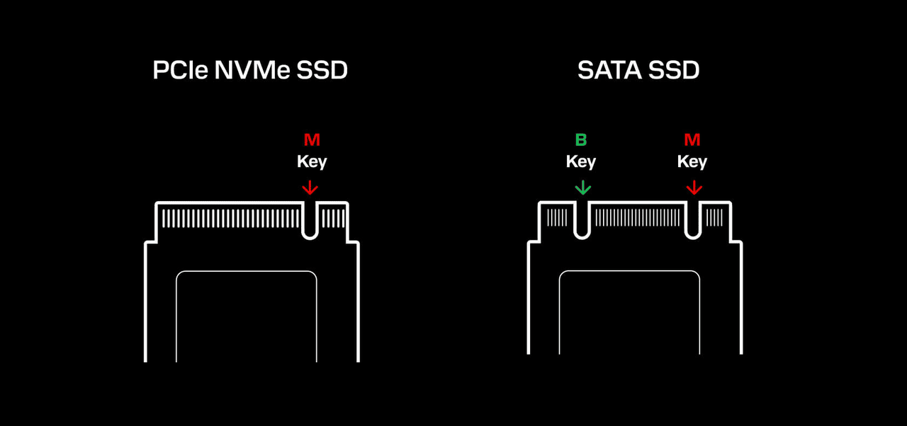

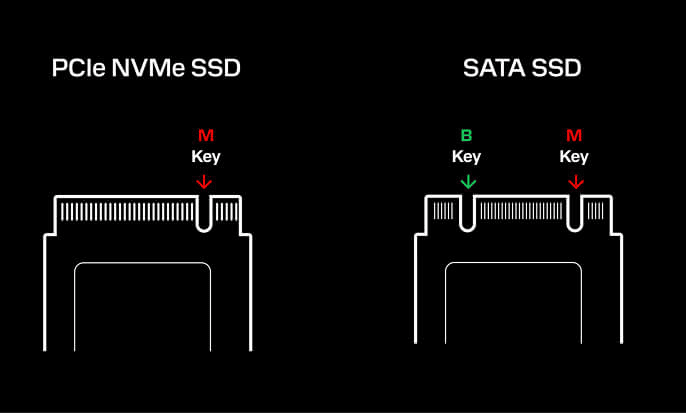

How to Tell SATA and NVMe M.2 SSDs Apart: B-Key vs. M-Key
Although M.2 SSDs look nearly identical on the surface, their keying (the notches on the connector) makes it easy to tell SATA and NVMe models apart. These notches help ensure that an M.2 drive can only be inserted into a slot it’s compatible with, preventing you from installing an NVMe drive into a SATA‑only socket or vice versa.
  • NVMe drives use the “M-Key,” which features a single notch on the right side of the connector, between a large contact block and a 5‑pin segment.
  • SATA M.2 drives typically use the “B+M Key,” which features two notches — one on each side.
Illustration of “M-Key” and “B+M Key”
