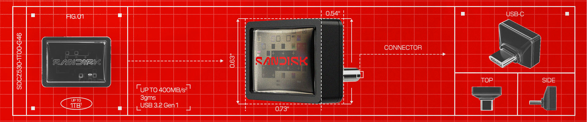

A collage showing multiple views of the smallest Sandisk 1TB USB-C drive, displayed against a red and black technical grid background.

The team's first breakthrough was to flip the convention and mount the USB-C connector perpendicular to the System-in-Package (SiP), the brains of the device.

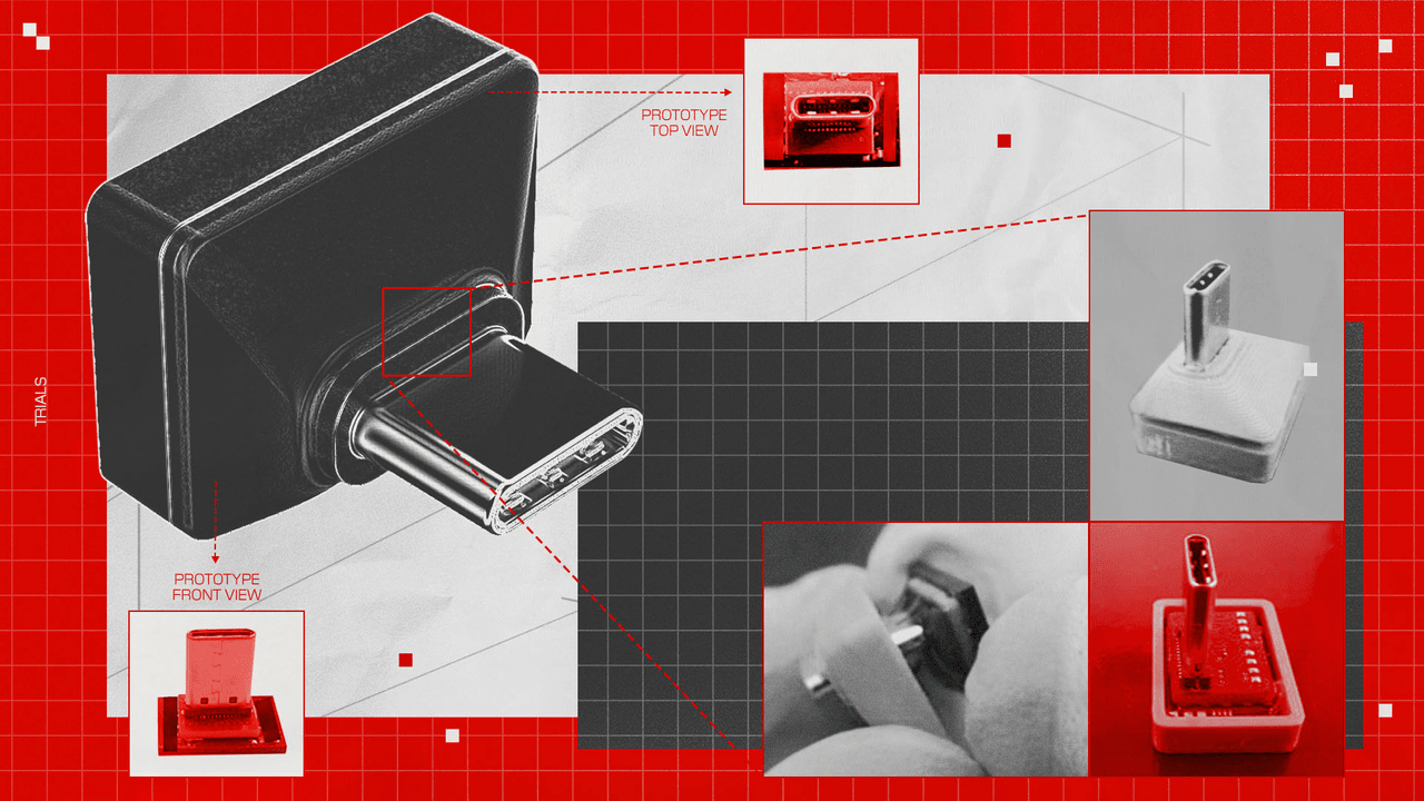

With no existing solution on the market, engineers devised a clever workaround using a tiny interposer Printed Circuit Board (PCB). The miniature PCB interface could route signals between the connector and the SIP while also reinforcing the extremely small and fragile vertical connection.
"This is the smallest SiP we have and the first time we created a vertical type C connector ever," said Deepesh Singh, Principal Engineer of Systems Design Engineering at Sandisk, who served as the product development team lead.
The challenge, he explained, proved greater than they imagined. A perpendicular connection is a little like balancing a piece of chalk on its end—maintaining reliable contact is hard. The joint must withstand shock, vibration, and thousands of insertions without microcracking or creep deformation.
"We built several prototypes, but they kept breaking," Singh recalls. "But there was an appetite for risk, a trust in the team, and we had the confidence to keep pushing."
